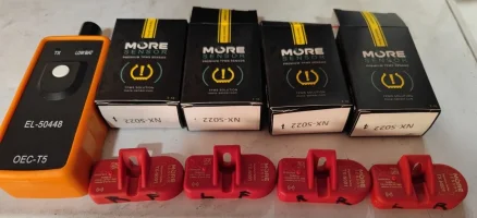

These TPMS sensors seem to well exceed OEM quality w/ 8-10 yr battery life, pre-programmed for the G70/Stinger, high quality steel stems, and can be angle mounted for more clearance w/ certain installs. They are here on Amazon for $50. Took only 2-3 miles to read and accurately register my pressure, so no problem recognizing these sensors.

Is there a particular procedure to programming new tpms sensors to the Stinger? Are they assigned by wheel position or does the car figure it out by itself?
I use More Sensor tpms with my other car but they had to be woken up the the $10 programming tool and individually assigned to each corner
The service tech at Discount tire used his scan tool prior to the install to ensure the TPMS were compatible, not sure if this "woke them up" though. I took the wheels/tires home and mounted them myself so doubt there was any assigned location.
My experience with three different brands of TPMS, including whatever the OEM is, says that the sensors require no attention. The car's computer interface does it all automatically.
