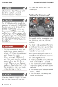

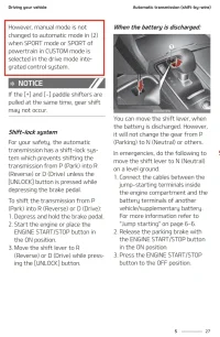

On my older gt with the t shifter, the behavior is the same as the shift by wire model when just in drive. Automatically goes to auto after a min or so if regular driving after pulling the paddle shifter in most modes unless you are in sport , then it stays in manual mode until you either pull the paddle for 3 seconds or come to a stop.
@viper & cnc; The above is from a 2022 owners manual. Perhaps the canadian models have different programming and behave differently than US models?
Ah I guess it's only hold for 1 second to go back to auto. It feels longer . But all the other parameters seem the same for my t shifter model when not in the manual gate mode.
In sport mode, mine stays in manual mode once I start using the paddles. it will stay indefinitely, but if I get really deep in the throttle, it will downshift automatically, or if I redline, it will upshift automatically, but it still stays in manual mode even after the auto shift. if I slow down dramatically (like just coasting down to 10 mph), it will drop down to 2nd gear. A complete stop and it will go back to auto. If I turn off traction and stability, it will hold gears indefinitely, like redline and just bounce off the rev limiter. essentially it does just about everything you would want under most circumstances, other than sometimes it won't upshift on demand when I'm on the track and really pushing the car. it's definitely not perfect by any means but it's pretty good.
