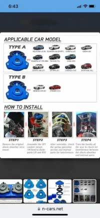

Apparently these are available in Korea but I have no further details or contacts for them.
1C01050C-7620-4B61-91A1-BA2B976E4FEE.webpE8603B28-E68E-4647-8AE8-94FFB240A27E.webp8D1EAEFD-F4E1-49A6-B331-39584F85D51B.webp
