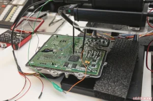

great that helps....am going to get this JB4, but curious about the high price, in looking at the chips in this tuner it looks like is very old 8-bit chipsets...am a software engineer so am not used to seen these chips for over 15 years now....so the price tag must come from the code
I presume all the tuner is doing is getting input stream from the ECU and then injecting parameters back into the ECU based on its own computed closed-loop I/O logic function(s), not something very difficult to code per say, and nowadays such code could easily run on a $15 esp32 arduino or raspberry pi board, which is a lot smaller, builtin wifi/bt and can do a million other things too......I dont think JB will open source their code, but I wouldnt mind taking a crack at it if there is some Kia documentation or anything that shows how to interface with the ECU (OBD2 protocol I would think)?

You are right as in the HW is not that expensive, but surprisingly the connectors that Nate with the stock harness may not be cheap, plus assembly. I figure maybe $100 COGS, but yes the research and development is worth something.

i found this picture, i see the infineon SoC being updated via SPI pins, looks very familiar.....ill hit up the guy from BMS
