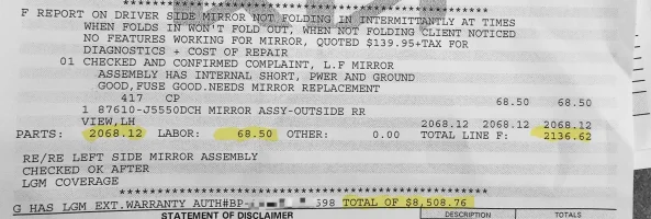

8k to replace the mirror? Holy, that's a expensive. I hope my warranty still covers it. Glad yours was covered and they were able to replicate the issue.
Nah, 8k was starter motor, 1 headlight, and 1 folding mirror
The folding mirror was only $2,136.62
Damn, that's still pricy. lol
I'm hoping my dealership can do it the same day, cause it's like 40 minute drive for me, each way. Sucks.
$2000 for a new mirror?
As long as he didn't pay for it. They can rack up the price. haha
I'm bringing my car in to get it fixed under warranty with my front bumper sensor, that's been dead for a few months now. I'll see how much they would have charged if it came out of pocket.
