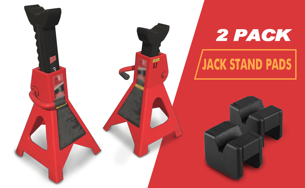

For the Jack Stands themselves, are the rubber/polyurethene/etc rail guards I got fine?
I just got a pack of 12 pucks from dicks. I think it was under $10/15 few years ago. Used 8 of them to make 4 pinchweld adapters, the other 4 went unused until now.
You mean the jack stand pads? Not sure. The stands you got have a relatively smooth arc. I think those pads are more for stands with a V profile. When using my pads, the weight of the car is not on the seam, but rather surrounding material.
According to this picture, and the comments, those jack guards can be used with my big red torins just fine
