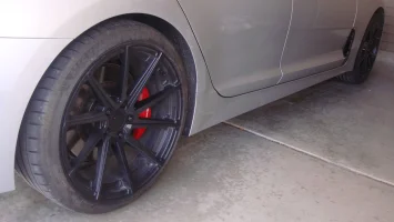

In my personal opinion I would like them to be very flush. I would like the wheels to fit the tires like the pic below.
^^^If you had my width wheels (8.5 and 9.5), I think that a 245 in front and 275 in back would give that look. Other opinions are solicited. :P
^^^If you had my width wheels (8.5 and 9.5), I think that a 245 in front and 275 in back would give that look. Other opinions are solicited. :p
C'mon, really?
Listing rim widths without their offsets is not being helpful at all.
C'mon, really?
I am only referring to the sidewall fit to the rim, not where the wheel fits in the wheel well.

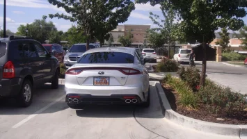

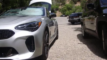

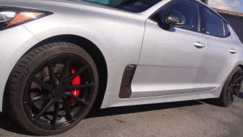

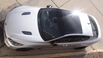

@SRV got me to post this information on what I run (when not on the OEM GT wheels in winter):
DSC08082.webpDSC07842.webpIMG_20190501_070403.webpDSC08420.webpDSC08936.webpDSC08937.webpDSC09236c.webp

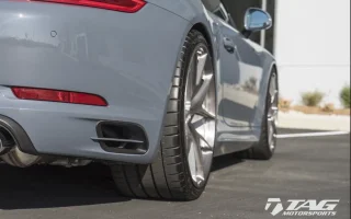

Front is 19x8.5 +35 offset
Rear is 19x9.5 +45 offset
Tires
Front 245 40 19
Rear 275 35 19
19x8.5 +32/19x9.5 +40
front 245/40
rear 275/40
ark GT-F springs- sits very close to flush front and rear, tight 1 finger gap in the back, loose 1 finger gap in the front. RWD.
