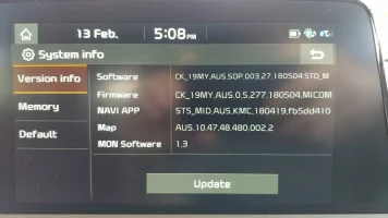

Make sure your map is current, ask for the upgrade they are free. Take a photo of your screen before, then check it after.
This is mine after update & I believe it’s still current.
Also ask to check any TSB campaigns for you car.
Hi there @Stinger GT SS , I just downloaded that version yesterday, but i need to buy an adapter for the Stinger's SD Card, my laptop doesn't have an SD Card slot.
My dealer updated mine, you may have to get a USB card reader.
I will buy a USB Hub with an SD Card slot tomorrow, I asked my dealership if they could update the Navigation Maps for me, they said NO, last friday when I took my Stinger in for it's 12 months service. Anyway , i have worked how to do it myself, i guess buying the adapter will come in handy for yearly updates.

You have the latest version.
That’s just lazy & poor service by your dealer.

Navigation Maps Update complete....:):), even though my dealership didn't offer to update it for me during my Stinger's recent 12 months service, maybe it was for the better, for one I learnt how the whole online process works, which I can use again for next year, and I didn't realise before that there was an SD card slot, just above the hazard lights button, and after the recent 12 month service, the less the technicians in the service dept have to put their hands on, in my Stinger the better, knowing my luck they could have decided to update the Maps for me, and caused other problems, like being careless and damage the Nappa Leather seat while getting in and out of the driver's seat, and waiting for the system too update.....:mad::mad::mad:
