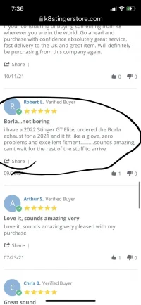

Ok someone posted on the k8stinger store that the borla was a direct fit for the 2022… so there is no way the borla tips will fit even with the bigger holes in the 2022 tips??

Ok someone posted on the k8stinger store that the borla was a direct fit for the 2022… so there is no way the borla tips will fit even with the bigger holes in the 2022 tips??That is awesome news. I am soooooo ready for an aftermarket exhaust. A few months ago someone here mentioned that they contacted Borla and were told the same thing. Borla is apparently working on a solution to 2022 exhaust systems as well with a November-ish released. Hopefully we'll see both MBRP and Borla come with something soon.

But.... someone else also posted this...
