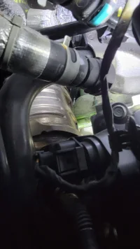

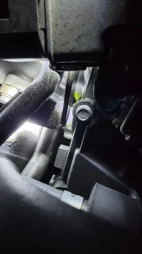

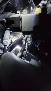

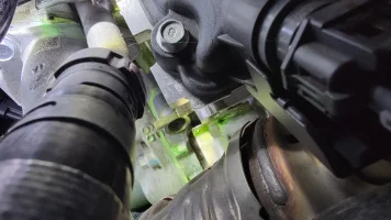

Looks like coolant keeps disappearing from the overflow tank and have a coolant smell inside the cabin. Dealer was not able to find a leak. Not long ago the engine warning light came up that engine was overheating and that is why I found out my coolant was disappearing. Going to pour florescent liquid into radiator to see where the leak is coming from as I am loosing hope at dealer's techs. Will also use the black light tonight to see where the leak is.

I think I may have found where the coolant system leak is after pressure testing the system at 20 psi. It seems to be by the firewall on the passenger side. I think the coolant hose right above might be leaking.

Makes sense that you have a leak like that if the dealer replaced your engine under warranty. They probably didn't properly secure or tighten the hose that's leaking during the swap.
