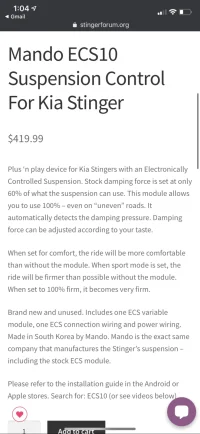

I genuinely do not know. It would probably take me an hour to find all the post of people complaining about the “bounciness“ of the rear end in the electric suspension. But those with the Mando suspension controller don’t have those complaints anymore apparently. I never experienced it because I don’t have the ECS.
Looks like Sport mode only uses 60% of maximum firmness, makes sense. There needs to be a reserve so as to never push any component to 100%. Our turbos are not at 100% max output nor is the engine or the drivetrain etc, why push a suspension part to 100%? Full stiffness is probably great for spirited and/or track fun, but this is not a track car it’s a luxury performance sedan. The ride quality would probably suck, especially on Long Island aka pothole island.
