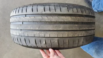

250 miles later on a road trip my front tires were thrashed on the outside edge. Huge chunks coming off a tire with less then 1200 miles on them.
Id recommend you let the springs settle for the rest of the week and definitely get that alignment. ASAP...20220521_160321.webp
