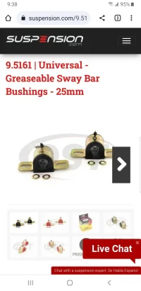

Would these be the bushings?​

I cant say with 100% certainty but that looks like it would fit the front sway bar.
Those are universal bushings for any 25mm bar, so I don't see why they wouldn't fit on the 25mm Eibach front bar. Only question is whether the mounting holes (or oval slots) would fit the factory mounting threaded holes for the front anti-roll bars. Chances are good they'll fit.
