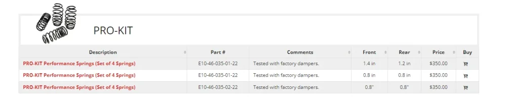

Hello, I am looking at springs for my 2018 Stinger GT. Wondering which springs to go with. Seems like everyone likes the Eibach springs but I am not sure which set is best for me. Hoping to match them up with Whiteline sway bars and Whiteline endlinks. THANKS!!
Take a closer look at the two options.
E10-46-035-01-22 gives the 3.3 AWD a 1.4/1.2" drop and it goves the 3.3 RWD a .8/.8" drop.
E10-46-035-02-22 only gives specs for the 2.0 RWD and shows .8/.8" drop.
Is your car RWD, AWD, 3.3L, or 2.0L
Oh Sweet...I was looking at that and to me what I thought was two options for the AWD and then with the different part number for the RWD
Based on how my 2.0 RWD sits on that set of springs, I'd say that is pretty accurate. However, I'd say the rear drop is closer to 1.0", but it depends on how the car is loaded.
