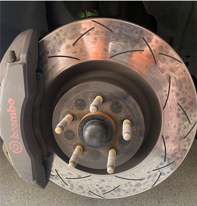

If your rotors are heat spotted, they should show clear signs of them. Maybe not this obvious, but something resembling these patterns:

Thanks for the photo. They don't look like that but now I have a better idea of what I'm seeing. I followed instructions exactly. They feel perfectly smooth when cold. I figure more use is more heat especially at highway speeds. More of an observation than determination.
No problem. That's what I figured. FWIW, if the brakes are functioning normally, it is pretty rare for heat to become an issue in normal driving. You'd have to be street-driving really aggressively, or in mountain passes with long steep descents, for the brakes to get hot enough to have troubles.
