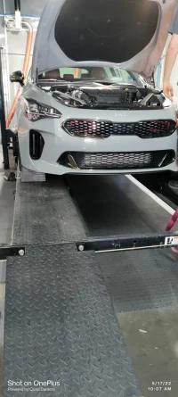

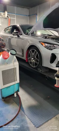

Run #1: 441.68 WHP @ 5,910 RPM 445.20 FT-LBS @ 2,740 RPM
Run #2: 444.82 WHP @ 5,850 RPM 443.52 FT-LBS @ 2,650 RPM
Run #3: 445.56 WHP @ 5,860 RPM 452.23 FT-LBS @ 3,920 RPM
Avg: 444 Wheel Horsepower 447 FT-LBS of Torque
The mods listed in the signature were present on the car at the time of all three runs.
(Edit Forgot to add this is on 93 Octane gas)

Very impressive numbers :thumbup:!
Interesting to see whp and wtq so close in numbers. Usually the tuning/piggyback options seem to favour wtq gains.
I have a RaceChip as well, but I've never hopped on a dyno. How long have you had yours - still enjoying it?
