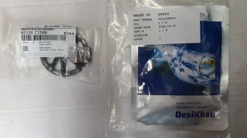

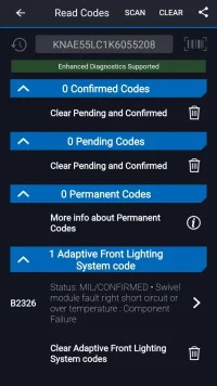

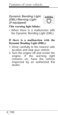

If the amber DBL is displayed on your instrument cluster this might be very helpful to you.
There is a TSB to replace the moisture absorbent packet and bracket inside the back of the headlight. The moisture absorbent packet gets so swollen that it presses against the servo module that swivels the headlights.
The Kia dealer told me it had 0 parts availability in the entire United States. I also was told that I had to stuff the blown up packet and broken bracket back into the headlight if I wanted it to be covered under warranty. What a bunch of BS.
So I ordered the parts directly from Korea.
Parts are crazy cheap from this website. Like 50-75% off for OEM parts. But the shipping isn't cheap. I chose the FedEx option for shipping. Parts arrived in 5 business days from when I placed my order. Skip the dealer and do it yourself.

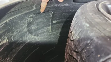

Jack the car up. You don't have to remove the wheel. There is a access door inside of the wheel well. Once you pop open the access door you will see the round piece which holds the absorbent packet. It's even labeled with open/close arrows. It might take some force to open since the packet is swollen and creating pressure.
If you plan to keep the car these absorbent packets probably need to be replaced every 2 or 3 years. Hope this helps someone.

old part number, bracket: 92126 G6000, new part number: 92126 C1500
absorber packet old #: 92125 H8350 new absorber packet new : : 92125 2W250

Use the parts numbers shown in the pictures I posted. They work 100% confirm, I did both of mine a few weeks ago.

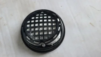

In May 2023, I got the dash error, and ended up getting the right side headlight assembly replaced under warranty. The dealer didn't even check the left (drivers) side, so I did, and replaced the desiccant pack and bracket (which was cracked from the desiccant pack) with the new part.
Today, just 7 months later, I checked and both desiccant packs were hard as rocks, and on the right side, it had expanded enough to bend the bracket.
My plan now is to inspect every 6-12 months, and replace if needed.

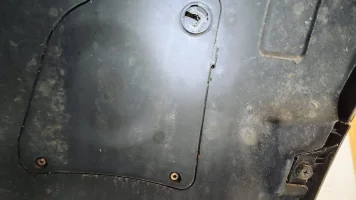

Tried yesterday to remove cover but guess what. I broke head of the clip. How did you do it?IMG_20240414_115557417_HDR_AE.jpg
What year is yours? And maybe the Canadian model is different. I've heard others say they couldn't remove the clip. Yours also has two pins in the bottom of the access panel which is different.
