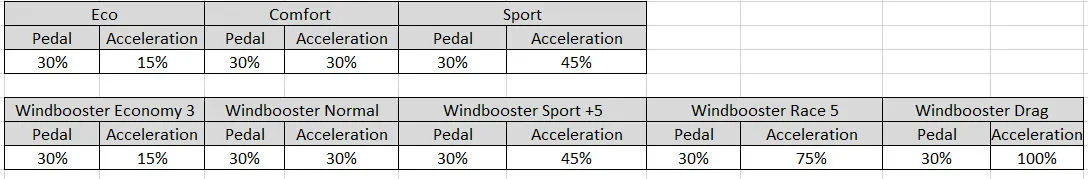

I put a simple table together – as a way of asking the forum whether I am on the right track with the interrelationship between drive modes and throttle controllers. The acceleration percentages are made up (just meant to be indicative) – I just want to know if I have understood the principle roughly ok?
When you combine Stinger modes with WindBooster modes – it is almost endless – so the above is just mean to be a simple limited example. If I am vaguely on the right track – it begs the questions as to whether a throttle controller on roughly medium settings gives any benefit over and above a Stinger GT in Sport mode with no throttle controller?

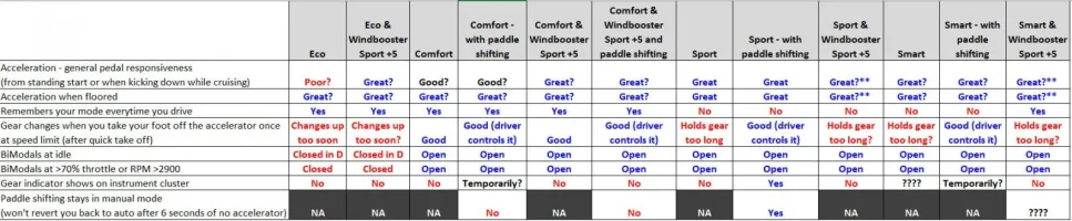

If I take the next step and look at some other nice to haves:
  • not having to set your Stinger drive mode every time you get in
  • having the bi-modals open more often
  • seeing what gear you are in (sorry – a carryover from my manual cars – I just like to know)
  • having the paddle shifting NOT revert to auto shifting (unless you want it to)
– it gives me the picture below (apologies for all the question marks … hopefully experienced members can help me replace some of them with facts):
So – now over to the experts. Where have I misunderstood? What modes do GT owners drive in? Do most use a throttle controller or is that just a minority of owners?
Any input / correction / feedback will be very much appreciated.
Sport mode will pretty much give you instant throttle response, and depending on how warm your tyres are, they may even spin on the rear.
I would be interested to know what it is you're doing to want an instant response most/all the time.
System defaults to Comfort mode, unless you were in Eco mode previously, then it defaults to/ stays in Eco. Try Smart mode, it detects your driving pattern and if you'll floor it then it'll bring you to Sport mode. May be a hit and miss.
Bi-modal exhaust opens up in the higher rev ranges so you'd need to get beyond 4,000kms.
You can only see gear numbers in manual mode.
Paddle shifters will shift back to auto at some point irregardless of mode, but Sport will hold it in manual for longer.
I drive in Comfort mode most times, because I bought this car for both comfort and GT factors.
From my understanding, you are correct. @Maxmad what might help your googling is the phrase "throttle mapping" that comes up with a bunch of graphs etc that show the relationship between accelerator pedal position and throttle %.
Generally when people talk about "lag" as it relates to a turbocharged car, they are talking about the time it takes for the exhaust to build to power the turbo (which in turn builds "boosts" to provide more air to the engine which in turn gives more power). There are factors that contribute to that specific lag, generally turbo size (smaller turbo spools up faster but doesn't provide as much top end power, bigger turbo takes longer to spool up, but generally makes more power), placement of the turbo (look up "hot v" setup vs where the Stinger's turbos are each placed on the outside of the engine), and RPM etc. Throttle mapping can not necessarily get rid of that kind of lag. @D.J. is correct, there is way to totally eliminate that lag (when comparing to a naturally aspirated car).
The lag you might be describing is feeling like the throttle isn't linear; you're pushing the pedal down 50% but not getting 50% power, therefore you add more throttle to try and compensate. This graph (while totally unrelated to the Stinger and it's throttle mapping) I think does a decent job of explaining what (I think at least) you are trying to explain. NA cars with ECO throttle mapping would also experience this kind of lag, but it is more pronounced in a turbo car just by the nature of the beast.
