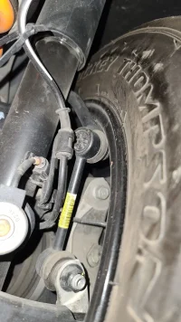

So I ended trying some 17x10.5 wrapped in a 305 45 r17.. wheel with 54 mm off set... it rubbed the sway bar end link but wheels was able to sit flush on rotor.
How close was it not to touching? Say 45mm offset?
