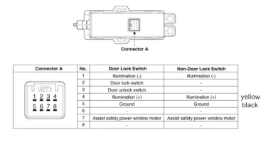

sorry - to answer for the driver door i ended up going with constant power when the car is on, don't recall which wire it was but i had to take off everything for a recall so in the process of putting everything back on
wasn't any option for only powering at night from what i found but when i get back to the driver door ill keep note of which wires i used, i left the t-taps installed
