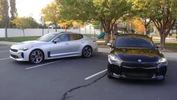

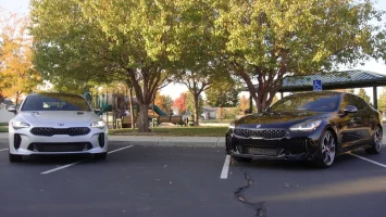

I realize that on my "back burner" is this question, still: after all this time, I still could not with confidence say that the DRLs are ON or OFF in a given situation. I do know that I put the Auto Hold ON when I took these pics years ago. But in "P" the DRLs supposedly go OFF, and above we are told that getting out when you have the trans in "D" and Auto Hold ON, and you get out, the trans engages "P", which turns the DRLs OFF, so, I don't know. And in all this time, I've never had this on my mind when in the car since, so, I cannot say, yay, or nay. :P
The Black is a GT2, at first with DRLs only, then later with headlights on and DRLs dimmed: I have no idea how @Gordo set his trans when he got out, or why his headlights came ON later when they were OFF at first (maybe he changed the lights setting and I didn't notice).
