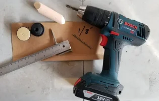

Items you'll need:
- Drill
- 1/8" metal drill bit
- Philips screw driver bit
- Ruler
- Chalk
- Optional longer screws (1 3/4") (shown below)
- Black permanent marker
- Hair dryer (or heat source)

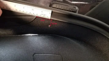

1. Mark, with the chalk, the hole you will drill per the diagram below.
2. Drill the hole with the 1/8" bit. Keep the drill steady with light to moderate pressure. You will notice once you puncture the felt cargo liner, there is about 1 cm of space until you hit the metal frame.

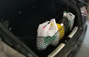

3. Dry test with the screw and the plastic round hook to ensure you feel the hole in the metal frame and the hook/screw line up nicely and hook is just flush or slightly below the rubber seal above it.
4. Heat the rear of the plastic hook to increase glue tack.
5. Peel backing, insert screw in the hook and place on the cargo liner into hole drilled. Drill the screw with the Philips drill bit on low torque. Use the marker to blacken the screw head. NOTE: If you use the supplied shorter screws, you will need to compress the felt cargo liner to the point it touches the metal frame behind it (about 1 cm air gap). I didn't want the felt to look dented in, hence the longer screws.

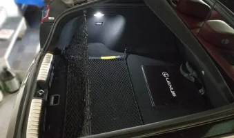

6. Mount the net's loops onto the plastic hooks. My net did not have bottom loops so I simply hooked the lower netting itself onto the bottom Stinger's metal hooks. You're done!

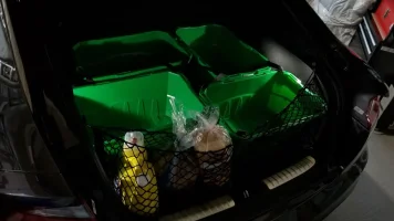

Versatility with grocery bins... :thumbup:

The drill spot measurement reflects an appropriate height to stretch the net enough for it to stand. The spot also is strategic to avoid nearby foam and plastic clips behind the felt trunk liner I found when stretching out the liner to find the appropriate drill spot. :thumbup:
