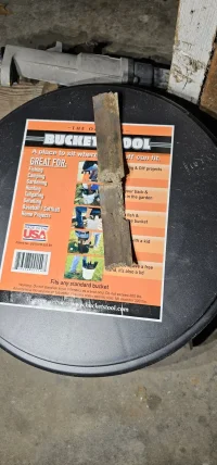

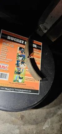

Anyways:

That's what I gathered from the research and the manual. Manual is slightly confusing though.
Anyways:
Ouch, is that from the parking brake shoes?
Wow, do you use the electronic parking brake regularly? Maybe park on an incline? It's crazy that it got so chewed up.
I used it all the time. In my mind not having the car roll back onto the gears was a good thing. Lol
I also used auto hold regularly and didn't turn it off.

Ahhh oh well. Was hoping maybe they could be related. I still do use the e/parking brake when I park the car. It was driven into me when I was young that it was good practice regardless of the car being automatic or manual.
Either way, very glad this issue was something as simple as the parking brake shoe instead of the actual diff.
