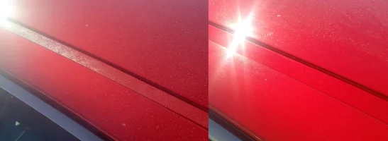

Yup mine have cracked.
Planning to raise issue same time as the HECU recall.
Yours have the snake skin look. Start a new fad. :D
