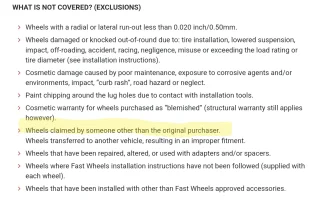

I see FAST wheels has a Lifetime Structural Warranty, but that only applies to the original purchaser (I bought them used 2 years ago).

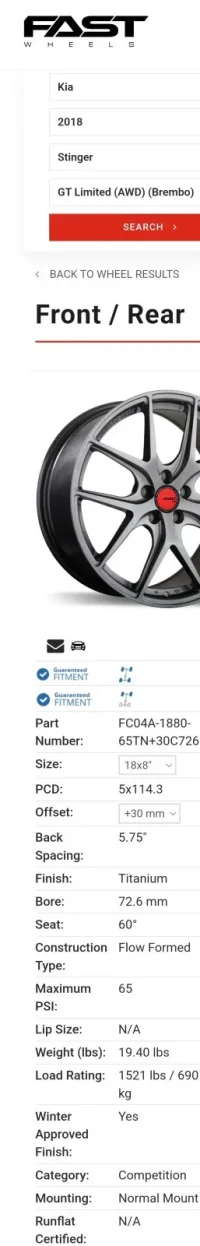

I got my FC04's from Canada Wheels and they appear to be in stock still?
Thanks.
I need 1 PC of Titanium with a 30 offset
FC04A-1880-65TN+30C726
When I search that site for Titanium and 30, only the black shows up, with 40
FC04A-1880-65BE+40C726
Regardless, thanks for sharing, and I will be calling them today to confirm.
I was going to suggest to check ebay. Sometimes you can get lucky and find discontinued items.
If the Titanium is available in ET35, you could get a 5mm hubcentric spacer to match your other ET30 FC04's. That's what we run with our Enkei's.
ET40 won't be quite as simple.
