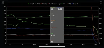

here is a quick screen shot at E83. Trims, AFR, HPFP all in check. Fuel trims almost look like stock. They stay very level with little to no adjustments.
Was it difficult for you to fiddle around with the JB4 & CPI to get the settings right so you don't run lean or have any issues with running it simultaneously with the Lap3 Stage 2.5 tune?

I always have them send me a long with base settings and CPI duty cycle at 50%. Then look at the log and adjust from there. With the latest firmware update it helped even more with fuel trims and allowing us to run more E85.
