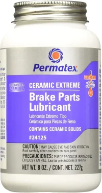

No I just cleared the contact point on the calipers and lubed the back of the pad and contact edges of the pad with this:
You do raise a good point though, I noticed that the pads were a SUPER tight fit when sliding them into the caliper. Maybe I should pull then and sand the edge of the pads so they dont have to be jammed in there so tightly. Im thinking it might be such a tight fit that the pads are almost crooked in there and that could be causing it.

Was copper grease applied to the back of the pads?
No, the grease I posted above was applied only to the back of the shim while installed on the pad. Im wondering if I need to pull the pads and add grease between the shim and the back of the pad but i find conflicting info on that online.
It's not as if doing that is a risk. What do you have to lose trying?
I’ve only seen the copper grease applied to the back of the actual pad to eliminate this sort of issue, so maybe in your case it cannot hurt to do it.
