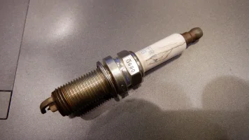

So, all together, it was a satisfying drive this afternoon. I'm still going to mention to the techs that I want them to check the plugs to assure that nothing visibly wrong is happening since they changed them recently.

Sounds like you picked up some bad gas. Be sure to ask the tech what they gap the plugs to or if they just toss them in and don’t gap.
Edit: Ahh didn’t see the cracked plug.
I'm pretty sure it was the cracked plug ;)
