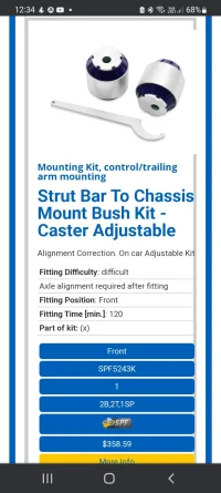

Camber kit, I'm on a list waiting a group buy down here still trying to get the numbers to make it worth it.
What is this "camber kit"?
Interesting stuff that. No its a tool I'll see if i can find some detail on Fb.
It is a kit to adjust the front wheel camber.

Yeah, I had long conversations with SuperPro. They commiserated, but had no plans for eccentric bushes for the Stinger.
