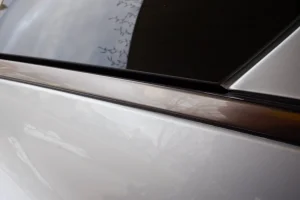

Bronze chrome door trim

be careful with the polish route as you are just taking off the outer surface. I believe the trim is similar to how they make black chrome or dark stainless (you're not polishing real metal). Other people have posted on here about compounds rubbing off the darker film on the outside and not liking the results.
Ya you don't want to do it often... clean it then coat/protect it
Agree , start mild with Cleaner Wax before using something that can damage the surface if not properly applied
Iam gonna try the chemical guys light metal polish and see how it goes.I will try a small amount in a small spot and go from there....Thanks all for helping me.
It probably doesn't matter. Indications are that it is stainless steel. Can polish it as much as you care to.
Same issue on my 2019. Asked about it at the dealership during my recall and they said it’s not covered because it’s a chemical burn. Was bummed out about it so I did what people recommended doing, which was use Flitz metal polish. It worked, but now the trim is lighter than the original. Now I have to even it all out. FML...

Thanks so much to everyone who helped me out with the solution to clean my dull bronze chrome.I used the chemical guys light metal polish
Yeah, that's why I stopped with the one spot. I see it. But I'm not ready to go over my entire trim and make it match a spot! Seriously. :rolleyes:
I relapsed in this determination and went over all six pieces, a couple of times now. At least they look more or less even in finish darkness (all somewhat lighter than stock). I've noticed that (aside from my original two "hard water spots") that the discoloration happens where passengers tend to touch the door to close it, i.e., up high at the rear corner. Over time, skin oils must interact with the clear coat. Other than that, my door/hatch trim has not discolored.
