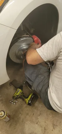

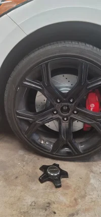

2019 GT2 owner; bought new in June of 19......at 40k I did research and changed to R1 concepts e-line drilled /slotted rotors......got AKEBONO front pads (high performance and dust free) with R1 concepts on the rear
Nearly 10k miles and nothing remotely close to the feeling prior.....my understanding is KIA cheaped out so to speak and put underperforming rotors on our beloved Stingers.
Quick story : KIA told me that they would true the stock rotors and replace the brembo pads for 800 dollars......I had the 4 rotors (upgraded mine you) installed with upgraded pads on all 4 for a total of 700.......20210722_083423.webp20210722_080556.webp
My understanding is KIA cheaped out so to speak and put underperforming rotors on our beloved Stingers.
