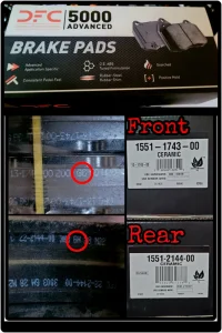

My last pad swap was with cost effective "Dynamic friction 5000 advanced"
Friction ratings are:
Dynamic Friction DFC 5000 Advance
GG for front (made in Korea)
GH for rear (made in China)
FG - is the OEM Brembo friction ratings [If you are not familiar with brake pad friction codes - Understanding Disc Brake Pad Friction Edge Codes and Markings]
I installed them on freshly machined OEM rotors - no sound/noise issues with them, they are working well for me (5k kms so far).

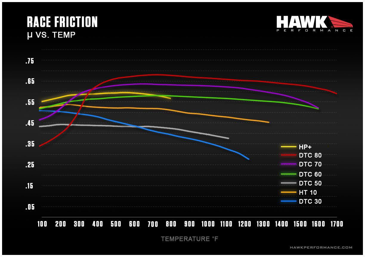

FWIW, the edge codes only tell a very small part of the story. It is not unlike the UTQC Traction codes, which is a gross simplification of the performance characteristics of any one particular tire. Not all AA-rated tires perform the same. Neither do all GG-rated or HH-rated brake pads.
At the minimum, I prefer for the mfr to publish a mu (frictional coefficient) vs. temp chart. Not all brake pad mfrs do this. This should give you a better indication of what temp range the pad perform well under. That, in turn, can be matched to the intended application(s) you are buying the pads for.
Hawke has one that shows an overview of their pads:
EBC also has them for their pads as well.

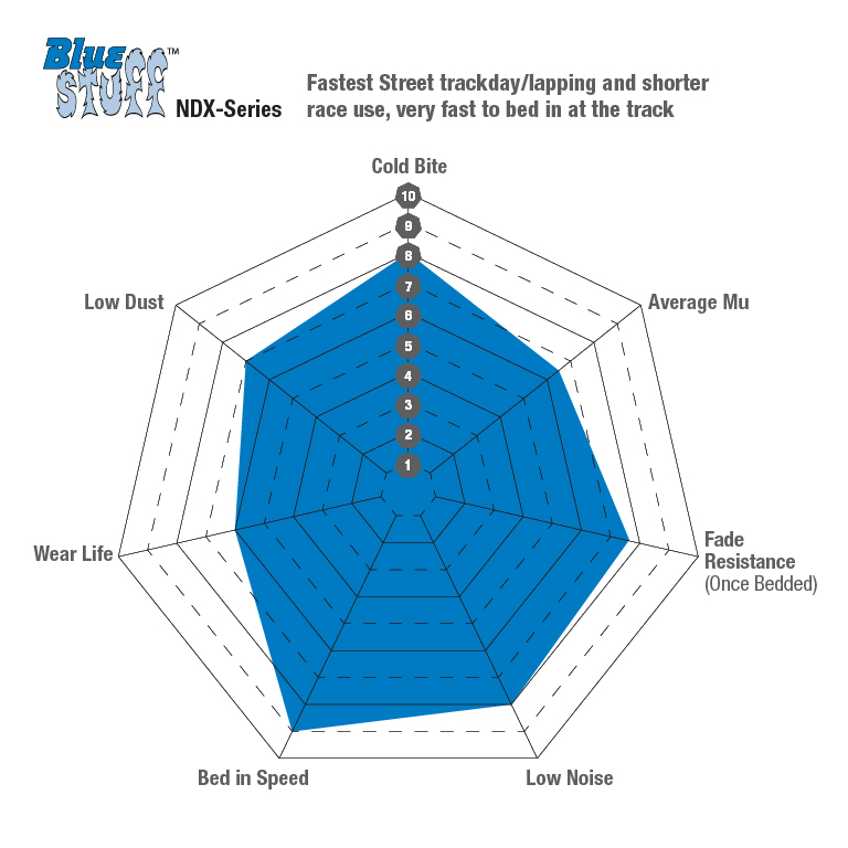

The next thing to look for is a spider chart of the various characteristics of the pad. Again, both Hawke and EBC publish them. Peruse through their website to see which ones suit your intended use and requirements. Not everyone look for the same set of needs and preferences. Here's an example for EBC Bluestuff, which is on my Stinger currently:
