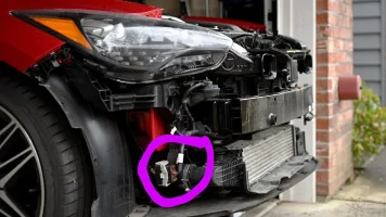

When I removed my bumper to install the snorkels, there was a large wiring connector on the passenger side (not the one you have to disconnect firm the bumper cover). On a whim, I disconnected it, sprayed some contact cleaner on both sides, reconnected it, and *knock on wood* have not had the issue since.
Photo attached. Connector circled:

I think I had that problem...I may have fixed it.
Hey @LordKOTL
Im currently working on this disconnect. What direction did you move the Grey clip towards?
Im trying not to break it.

This didn't solve my problem unfortunately. I saved time by just removing the bottom protection instead of removing the entire bumper.
Sorry it didn't work for you. I can't remember the direction I moved the grey clip, but it wasn't difficult and I didn't feel like I'd snap it if I forced it. If you do find out what the issue is please post it *just* in case it comes back for me or if someone else has the issue.
Good luck in tracing it down.
We ended up changing out my passenger front wheel speed sensor, though i still randomly get the errors when its really cold outside. I'm still hunting my issue but I think there are multiple potential causes for these errors to pop up.
