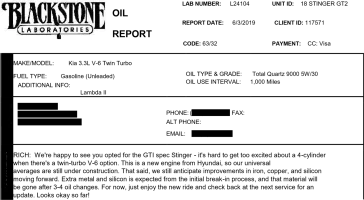

Blackstone oil analysis results
Thanks for posting this up!
I agree, normal for first oil change.
I am surprised (to say the least) at how much calcium is normally in motor oil... :O
It's a detergent. But, that is a similar amount compared to my previous cars. So, I'm not worried.
I know you can get lower calcium oils, they'll use other additives for cleansing though.
I love the personalized comment from the tech, that's a nice touch. Results look good which I'm happy to see as a fellow owner.

Thanks for the thread! Here are the results from my last oil change at 11,500 miles. Interesting the differences in calcium and moly.
