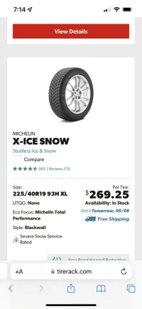

Also curious about best setup for winter. So these will work with the 8.5’s in the rear?
They will, but you won't be able to rotate the staggered OEM setup; the offset of the 8.5 rear wheels is 46.5 and will not clear in the front (you wouldn't want to run wider wheels in front anyway). Get a winter set of wheels with an offset that works on all four corners.
Thanks for the info. I actually bought a staggered wheel setup for my previous stinger that had square 18 setup but then traded it. So now unfortunately I only have staggered setup to work with. That said, I’ll probably just have to stretch them and bite the bullet for decreased tire life.
