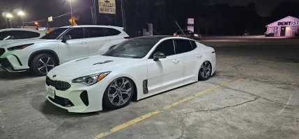

This is my vehicle on 18s and I was think either going to 19s or 20s
Just trying to figure out the best fit without having to put on Hub centric spacer

How big did you go on the wheels, 19 inch or 20 inch
20+9 front +32 offset 20+10.5 rear +45 offset the front would totally clear bagged but the back would rub maybe a +48 offset with the car sitting on the ground would be ok be a risk to find out
