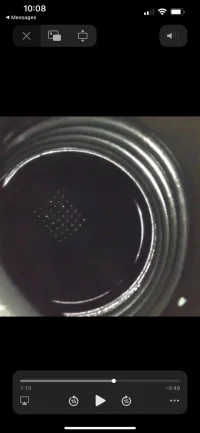

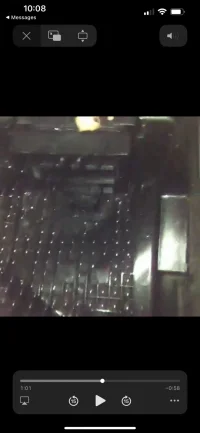

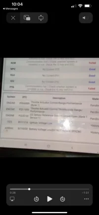

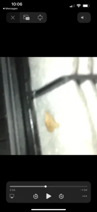

Here’s the extent of the “proof” that its hydrolocked pulled from the dealer service video.
Photo 1- wick line of moisture on stock paper filter
Photo 2- clearest photo of thrown codes provided
Photo 3- photo of bottom of air box (below filter)
Photo 4- best view of intake manifold piping claiming it’s got enough water to lock to engine

The only thing those photos prove is that they can't operate a camera.
If the air filter isn't dripping water, there's no way enough is getting through to hydrolock unless there's a design flaw.
