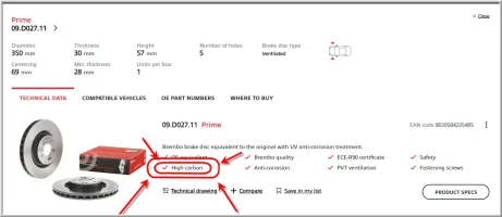

Says high carbon right there in the description. That's OEM. If you look it up on Brembo's website, I think that it also says High Carbon.

What's weird is that the description says "Brembo Premium OE Rotors are part of Brembo's High Carbon range, offering a premium alternative to the OEM rotor with several added benefits.", suggesting that they're different from the stock factory rotors, which would explain the unique part# they use to differentiate them.

I think that Brembo is saying their "Premium OEM line" is better than stuff most OEMs ship by default, just like our "OEM Premium Brembo calipers" are better than "OEM calipers" from Kia on the 2.0, etc..

Your OEM Brembo rotors are - HIGH CARBON.
And your OEM rotors have the additional benefit of PVT ventilation - not just vented like the dynamic friction or centric.
I suspect (not confirmed) - strongly suspect, that the dynamic friction & Centric rotors you are looking at will be only up to as good, but not better, than your OEM Brembos.
