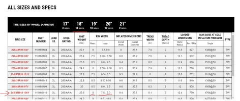

Yeah so I consulted Yohokama, just called them up, and they said talk to a dealer. TR techinically is a dealer. I'll call a local tire shop i guess. See what they say
They are saying 7.5-9 for a 245, although they say "approx", it seems like 245 and 8 would work according to them.
hmmm fascinating. I just got off the phone with a local performance shop and they said to stay away from the 245s with a 8.0 rim bc the tire could roll, akin to what you said.
Yet if this tire manufacture said that their tire can work just fine with that rim, then we should be fine right?
Edit: wait nvm, he also said that since it was AWD, the overall diameter had to be the same too. So stock is 25.9. The 235/40 is .5 under (25.4), the 235/45 is .5 over (26.4). The 245/45 i list above is 26.7, .8 over. That may be too much.

I spoke with the local high performance shop and they said that I could get 245/40R18 97Y just fine on the 8.0 rims. Squared obviously. These sound alot better for track than the 225s and 235s. I know that ideally 18x9.5@255 is the best, but that means buying new enkei rims at that size, and these f*****s are like $250-$350 per rim. I highly doubt im going to notice the difference between 245s and 255s.
