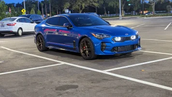

Got my wheels mounted, tech showed me before they were bolted on they wiggle a little bit and suggested I get some rings. Fitment industries site did not recommend any, nor the few examples of stingers with these wheels in their site. Can anybody point me to which size rings to get? I've never had to buy rings for wheels before. This is new to me, tho I understand their role in fitment.
Also, they look great.

The website for the wheels fitment industries list it as 73.10 and for the stinger at 67.1 so that's what you need for hubcentric ring.
Minimize your driving till they're installed or you could run into problems.
Every time you lay into it, the wheels are going to twist

I personally wouldnt even drive a car with wheels that either werent hubcentric or had hubcentric rings installed.

19x8.5 front
19x9.5 rear

just a little update. finally got the rings put on yesterday. and had a dry morning with no rain on my way to work. no vibrations up to 100mph. car feels good.
Thanks for the help.

275/35/19 and 245/40/19
they are .6" taller than stock, but they fill the wells nicely. 275/30 is .5" shorter than stock... so if your lowered maybe go in that direction.
once the sun comes out for a few days ill post some good pics.
