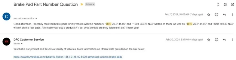

K8SS brake pads are just rebranded Dynamic Friction Company Brake Pads... at over $100 markup. So for those looking at the K8SS brake pads as an option, save yourself $100+ and buy them directly from Dynamic Friction Company. IMG_8322.webpIMG_8325.webp
