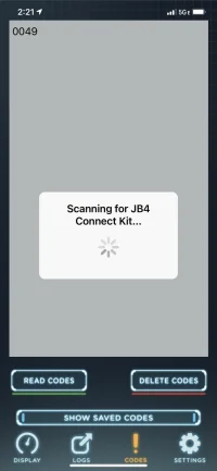

I set it to map 2. for I want to say three minutes. did a pull and my check engine light came on with this code. the car didn't have much power or let me even use launch control. I cleared the code and the car runs as nothing has happened to it. still not pushing it or anything tho. and no I didn't. stock exhaust all the way at the moment.What map are you running?

I shall give this a read right now! I appreciate both of yall. also sorry for my wack-ass punctuation.P0049 OBD-II Trouble Code: Turbo/Super Charger Boost Control Solenoid Circuit/Open

good point! definitely need to start logging stuff up after that. I thought the same tho because it has never happened before and I push that car honestly! but I don't mess around with the higher maps I'm normally always on map 1.Overboost on map 2 with stock exhaust is pretty strange. It's quite common when replacing the primary downpipes with aftermarket cats and running the more aggressive maps.
The car went into safety mode, so it's highly unlikely anything got hurt. It's good at protecting itself. The safety/limp mode clears after stopping the engine.
Keep the app going and turn on logging, see if it happens again. If it does, reach out directly to the Burger guys. Might just be a fluke of the conditions. Make sure you have the latest stable firmware flashed on the jb4, just in case.
