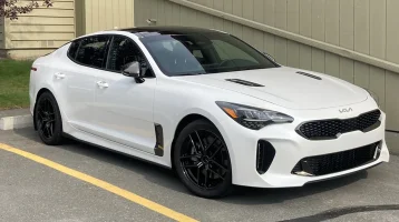

I’ll tell you that 18 8.5 with 35mm offset 255 tires works, but it’s VERY tight. The closest point is the rim/strut. The strut gets further away the higher you go.

Do you have any pictures to share? Would love to see how a 18x8.5 with 255 looks like. No issues with rubbing in the front on full turn?

Although I was taking off my winters, I couldn’t find any evidence of past rubbing this week, putting the summers back on. I know I checked for rubbing at full lock before, but that strut is really the critical close thing. AE3359CB-D078-4DCD-8E5E-994186CED932.jpeg
Happy on the fitment and look of the 18x8.5 square setup! The ride is so much better.AF78546F-E558-4B2C-BFC9-CBD31019B95B.webp
