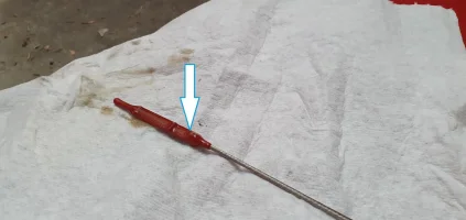

1. Engine Oil over filled ( not a huge amount but enough that I drained it to the correct level ) and no I didn't check the level with the dip stick at this angle.

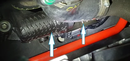

4. Oil Residue from filter area ( before I cleaned it up ).
