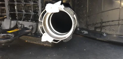

Just received my agency intercooler going to put it on soon but I've heard the driver side seal clamp is difficult to get off does anyone know how it unclips?
I just so happens that I installed mine Yesterday. I have a 19 and the instructions they sent do not match what I had to do. The drivers side is indeed a pita to get off. There are two wires that are contiguous and wrap around the whole things. You need two screw drivers to prop open both sides at the same time. Even though the wires are maxed out there is still a tad bit of that wire that holds on to the ledge on the inside. I got mine off with brute force!

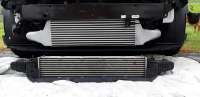

Agency intercooler installed went pretty easy here's a couple pictures of that tricky hose should make it easier for someone else20191019_115507.webp 20191019_125128.webp 20191019_125128.webp 20191019_115507.webp 20191019_125128.webp 20191019_115507.webp 20191019_115626.webp 20191019_115507.webp 20191019_125128.webp 20191019_125128.webp 20191019_115507.webp 20191019_115626.webp 20191019_132757.webp 20191019_115626.webp 20191019_115507.webp 20191019_125128.webp 20191019_125128.webp 20191019_115507.webp 20191019_115626.webp 20191019_132757.webp

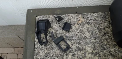

Did you have to trim plastic like I did? Is that what one of those pictures shows? The cut plastic?
Yes those little bits and pieces were the plastic that I had to trim off, I just used my handheld grinder
