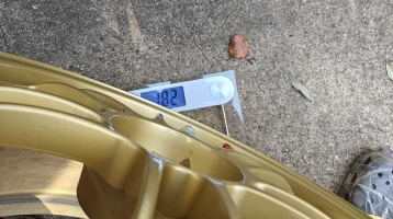

Pulled the trigger on 18x8 ENKEI PERFORMANCE XM-6 wheels with 225/45 PIRELLI P ZERO AS PLUS 3. These are about 20 lb wheels, vs 35 stock wheels. Plus these seem to be great tires. Fingers crossed!
