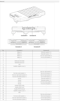

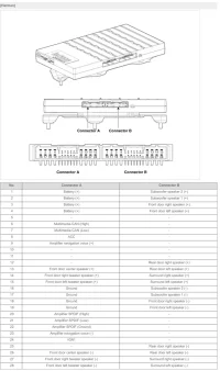

Am I missing something here? That harness wiring diagram must not be for the 15 speaker HK system is it?
The image in post 12 and 16 is correct for the HK system. At least on my 2018.
The orientation is confusing, look carefully at the amp orientation. Connector A in the image is actually labeled with 2 on the harness. Connector B is labeled with 1.
Wanted to chime in... 2019 GT2 and the Subwoofer +/- pin outs were correct... and yes, the amp is mounted strangly. It's screwed in "toward you". If you've pulled the fuse panel and are looking at it it's backwards from what you would think. The "red" plug had the subwoofer outs that I needed. The blue plug has an ACC if you need +12v ignition/on.
Thanks a million for posting the pin out, saved me a ton of time trying to locate these. I'm using the subwoofer 1 & 2 as high level inputs to a Punch T750x1bd amp that has build-in LOC/auto-turn-on. Pushing two JL10w3's. The new amps are small and fit perfectly behind the spare tire.

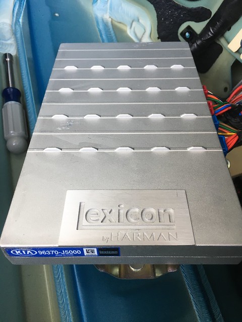

Could you post a couple of pics?
Sure... here's a shot of the amp mounted and wired up. I didn't take a pics of the fuse/tapping but Theemfinger has some great shots and the schematic in the referenced 8" sub upgrade post.
