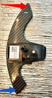

Has anyone had any experience with this company or these replacement paddle shifters?
They appear to be the longest full replacement paddles at 160mm, but if anyone has had a good experience with longer paddles I’d like to hear.
Not interested in extenders to the stock paddles, though.
Thanks!

Do they operate smoothly if you pull them from the extremes (where the red and blue arrows are?)
They don't appear to be much less wide than the OEM!
No.
The answer is a resounding no.
They do not work at all at the extremes you’ve indicated…or even halfway out that far.
There is so much flex in the way the paddle is connected to the stock electronic module that it fails to shift if you’re anywhere past where the stock paddles ended.
I can’t see how even the stick-on paddle extenders could be worse.
And since these are further inboard from the wheel, the stock paddles are much, MUCH better.
I was REALLY hoping these would work, but since www.shopkiastinger.com doesn’t care that their product has no advantages and blames me for not asking before I ordered if their extended paddle shifters extend where the paddle can trigger a shift (really?) I’m out $250.
Guess they think we’re all so stupid that the only thing we care about is cosmetics…that our paddle shifters look longer and have a black weave…and that we don’t care if they work or not.

I’m very serious. Before I drop $450 for sxthelement, my original first choice, can you post a quick video of the actuation at the extremes?
Please?
I too, have significant doubts.
I can't see how the carbon fiber version could be better since they use the exact OEM switches, the OEM switches are not very tolerant of off-axis performance.
I cannot see how they could possibly be better at the extremes of the paddles
Skeptical I am
Very top there is some flex, rest of it solid.

I didn’t explain it well enough. Yes they are longer but thinner so you would need longer fingers to easily reach and I wasn’t the biggest fan of that. It’s not completely out of reach, just a bit thinner than OEM. I still have them on, I would buy them again for looks alone since I prefer stick shifting more anyways.
Man, I’ve learned my lesson. I REALLY should have read between the lines here as the information I needed was implied in this response, and that is:
“The shopkiastinger.com paddle shifters are for looks only. I think they look great, but they’re so useless that I now have to use the stick to trigger shifts.”
I was so hopeful that they would work that subconsciously I must have thought either that I’d get a better-built pair now that they’ve had this feedback or that I’d figure out, with my decades of automotive customization to meet my performance needs, how to make them work for me.
In fact, their website now states: “Extended paddle shifters do not extend the reach of the paddles connecting to shift. These are OEM paddles with carbon fiber molded on top to extend the length visual aspect. The only option for extended paddles that will also connect at the top and bottom when you shift on them would be choosing magnetic paddle shifters which are a much higher cost.”
Wish they had been so honest before.
In case I haven’t posted this, the SXTH Element magnetic paddle shifters are great.
They work as expected (and as advertised) all the way to the very, very end of the points at the tips! I almost don’t mind that they’re not as long as hoped since they work so well. Another half inch, top and bottom would have been ideal, but as they are they stay out of the way when not needed yet only very rarely are out of reach.
The blades screw on to the actuator (an all-metal complete replacement for the bendy stock one) and there’s a few to choose from. The woven CF is dead flat, the molded CF are forged and have a smooth, subtle ridge on the backside for grip (my choice), I don’t have info on the aluminum.
