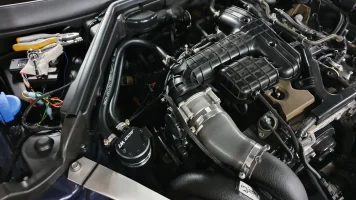

The first thing I want to note is that the kit is very well outfitted. Literally everything you need is included from the nuts and bolts for the custom bracket down to hose clamps and pre-trimmed hoses. FWIW, my hoses were trimmed pretty poorly, so I took a razor and cleaned the trimmed edge so that it would mate smoother and flush against the fittings. Also, the bracket inherently holds one can, so you'll re-use the catch can's own bracket for the other side (it won't look symmetrical if you have minor OCD like me).
The install itself is pretty straightforward, so I'll skip that. Instead, there are some notes I'm going to make that may help you:
- The instructions call for teflon tape around the fittings that go into the catch can. If you're like me, the thread seal tape you have is a standard width of 1/2". The thread length on the hose fittings is 1/4". I cut my tape in half lengthwise, but it was a bit cumbersome to do if I'm honest.
- The 9mm fitting on the car looks hard to get to, but the bracket in the way is easily removed by unbolting the single, silver bolt holding it in place. Unbolt the bracket and you have plenty of space to work with.
- My stock intake hoses would not come off by hand. The hoses were not only on tighter than my wildest dreams, but I yanked and gripped them until I was shifting my engine and car a bit trying to yank them off. You might need a hose removal tool. Since I didn't have one, I went the one-way trip of slicing the hose lengthwise across the fitting. Of course, they were so tight that I still had to actually pry the hose off with a flathead like they were glued to the fitting! So, fair warning: these hoses might be more stubborn than you're used to. Come prepared.
- The 9mm hose is very loose on the car's fitting. It seems as if it's a 9mm hose on a 9mm barb (usually, the barb is .25mm to .5mm thicker), and I cannot emphasize enough that you should absolutely attempt to overtighten the hose clamp and visually look for a bulging squeeze. This hose is just way too loose for standard tightening.
- My custom bracket's installed position caused the back catch can to actually rub against the plastic guard rail. You can see the white rub mark where the can was touching. I noticed this early on. I added bonded washers between the bracket and the wheel well so that the bracket was further away and would not rub on the plastic guard rail.
You can see the little white mark where the can just started to rub above where the can used to be.
After the bonded washers, there's more "comfort" space so that it won't ever touch.
- Routing the hoses along the front requires a bit of finagling, and if you're like me and want to keep the engine cover, you'll have to play around with the routing a bit to avoid pressing down on the hose near the front driver's side engine cover mount point. Also, the route in the installation instructions had too many tight curves in which hoses were pressed up against or rubbing other edges. I made some slight changes to the positioning so that there was more slack in the hose and so it pressed up against nothing sharp or "edge-like" at all. I do agree with the zip-tying, though: it doesn't touch that pulley, but it comes damned close if you let it hang loose.
At first glance, it looks like the instructions, but...
These hoses are routed slightly differently which gives them a little more slack and also no hard rubbing on edges. However, you can see one hose still has a mark and indentation where it rubs the lip from the engine cover that goes over the mount pole just to the left of it.
All is not well, though, as the engine cover rubs this other hose and I'll have to figure out what to do about it. You can see the tiny bit of marking as this is still a fresh install. 5000 miles from now and that rub may look very different.

Trying to revive this old thread. I just got the dual catch can set up and as a less mechanical inclined person, the instructions were less than helpful. So I have two questions:
1. The instructions specifically asked for Teflon tape on the mounting bracket. Was this for the Allen screw screws on top of the cans?
2. The kit came with two washers and a nut for mounting the bracket onto the car itself. A locking washer and a traditional washer. What order did you put these on? Locking washer, then the big washer, the bracket, then the nut? I'm worried about the bracket coming loose after extended use due to vibration.
Thanks!

I don't recall that part, I just know it asks for thread seal tape around the threads of the fittings.
As for locking washer vs regular washer, going from the chassis' exposed bolt, you would put the bracket on, then the regular washer, then the locking washer, and then tighten the nut down on top of that.

The PCV hose doesn't come off :(
How do you do it? what kind of tool did you use?
Need to hold the clamp open while pulling?
Ok I did it.
The trick was to move the clamp up on the hose and then insert a small screwdriver beneath the hose to losen it up then pull while shaking.
Ok I did it.

Yeah, I'm also very happy with the purchase. The only thing I was unsure and still unsure about is the bracket mount. Will have to check for wobbles at the next oil change!
What do you mean? The bracket mount fits perfectly.
It does, but it was an awkward angle for me to tighten down the nuts since I didn't have a socket wrench (I think that's what you needed)
It can wobble a little bit, but it's never really an issue. This is because you can see the metal surrounding the base of the hole where the bolt comes through is painted over, and it creates a sort of small lip. I had it on for 10000+ miles and it was never a problem.
