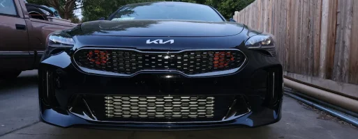

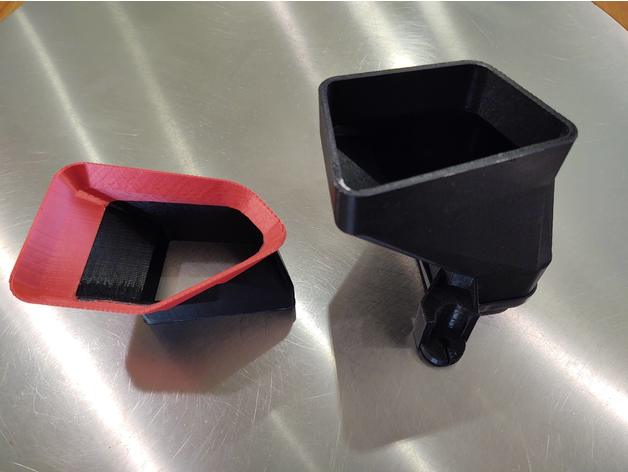

So now that the options for intake snorkels, (airscoops, ram-air, etc.) have been severely limited, I thought it'd be a good time to release the 3D files for the ones I designed last year.
These snorkels are 2-piece for easier printing and install. They only require a small hole to be cut into the radiator shroud, though you can always remove it entirely. The base piece should be printed in ABS or PETG for heat resistance, but the front piece can be printed in PLA for more color options.
The 2-piece design also allows you to make different shaped mouths to use with the base piece. Mine is angled to flow better with the grille shape, but if someone wants to remix the front piece to be rectangular like some other options or any other shape they want, just edit the STL file.
One reason I didn't market these was me having no desire to do tech support, so while I'll try to answer questions where I can, this design is offered as-is and is fully DIY. I designed these fully myself and it was a good deal of work to measure and design multiple iterations of these until they fit right. I did not copy any other designs that may be out there.
I am offering these up for free, I only ask that nobody try to sell these, and give me a like on Thingiverse if you download them. If you remix a new front end, please cite my design as the basis.
grille on 1 - Copy.webpseparate.webpcombined.webpgrille off.webpgrille on 2 - Copy.webpShroud1.webpshroud2.webpshroud 3.webp

Question about the hole, it looks like you're tracing the end that connects through the radiator wall (?). Does this imply the angled bit of the base part stays the same size until expanding for the mouth/intake side?
** Looking again, I may have the process flipped in my mind, but I suppose some clarity on that step might be useful.

Looks great, @Thwack. had zero issues working with PLA.
just a heads up, the PLA will slowly warp/melt in the hotter months, you should print it again in PETG/ASA and then coat it in High temp resistant spray paint.
